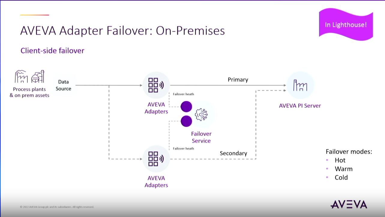

    WHello,
    With the recent release of failover support for OPC UA and MQTT Adapters, does the MQTT Adapter support server failover or only client failover? Or is server failover (data source) only for the OPC UA Adapter? I'm not able to find information on configuration steps for server failover with MQTT Adapters.
    As per the attached pic, with two Adapters and a PI Server, is the Client failover service typically installed on the PI Server?
